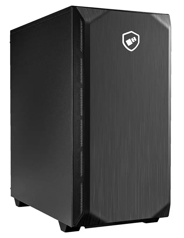

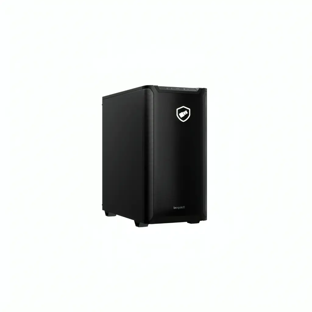

NitroPC Pro 2 - The Secure, Powerful Workstation
The NitroPC Pro 2 is the workstation for high security and performance requirements. The open source firmware Dasharo Coreboot ensures high transparency and security and thus avoids backdoors and security holes in the firmware. The device is certified for the highly secure Qubes OS and comes with either Qubes OS or Ubuntu Linux. Carefully selected components ensure high performance, stability and durability. The Dasharo firmware guarantees continuous firmware development and fast firmware updates.
