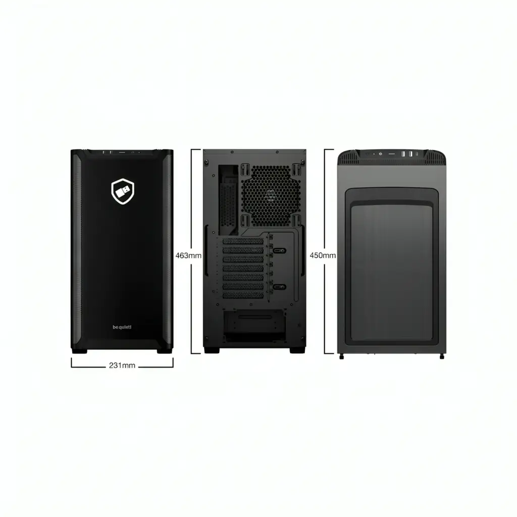

  • Firmware: Open source Coreboot distribution Dasharo, 1 year subscription inclusive
  • Operating System: Qubes OS, Ubuntu LTS (optional)
  • Processor CPU: 14th Generation Intel Core
  • Graphic GPU: Onboard Intel UHD-Grafik 770. Other graphics cards on request.
  • Speed of the SATA SSD: >500 MB/s

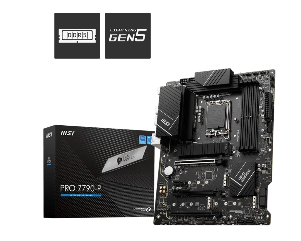

  • Mainboard: MSI PRO Z790-P DDR5 (WIFI optional)

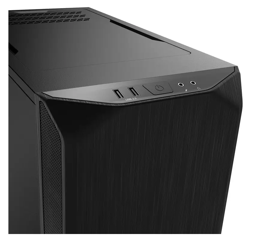

  • Connections front:
    * 2x USB 3.2 Gen 1, 5 Gbps
    * 1x audio jack input
    * 1x audio jack output
  • Connections rear:
    * 4x USB 3.2: 1x (Gen 2x2, 20 Gbps, Type C), 1x (Gen 2, 10 Gbps, Type A), 2x (Gen 1, 5 Gbps, Type A)
    * 4x USB 2.0
    * 2.5 Gbps Ethernet LAN Intel I225-V
    * DisplayPort
    * HDMI
    * PS/2 combination port for keyboard and mouse (UEFI only, doesn't work with HEADS)
    * 2x Wi-Fi antenna (optional)
    * 2x audio jack input
    * 4x audio jack output
  • Power supply: 850 Watt, silent, be quiet! Straight Power 11, 80Plus

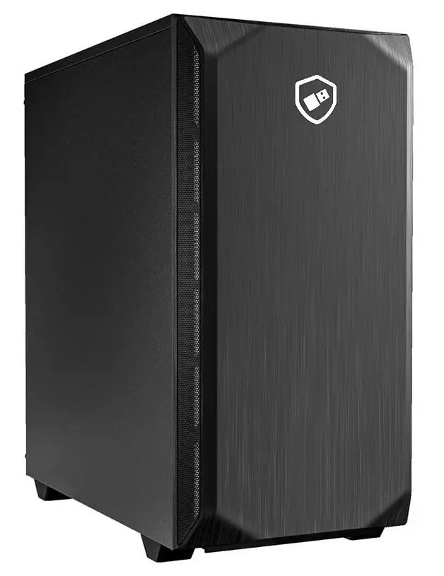

  • Casing: black Midi-Tower

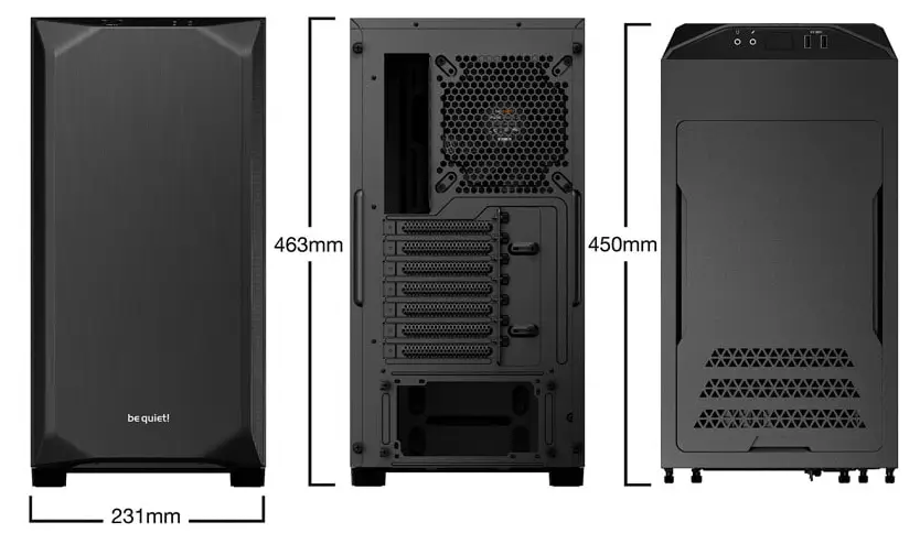

  • Dimensions (with feet): 231 x 463 x 450 mm (W x H x D)
  • Weight: ca. 10 kg
