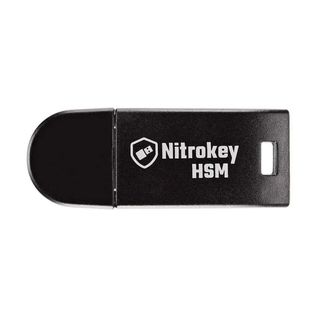

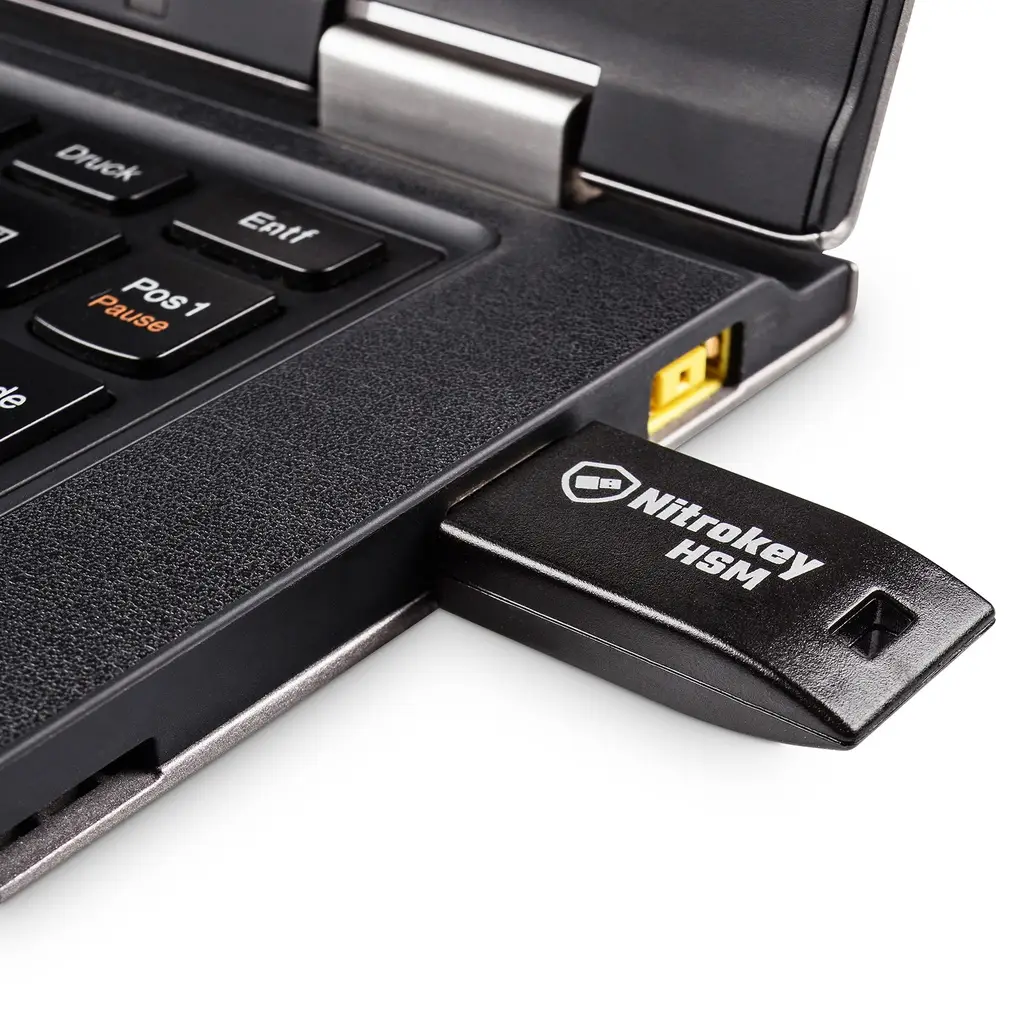

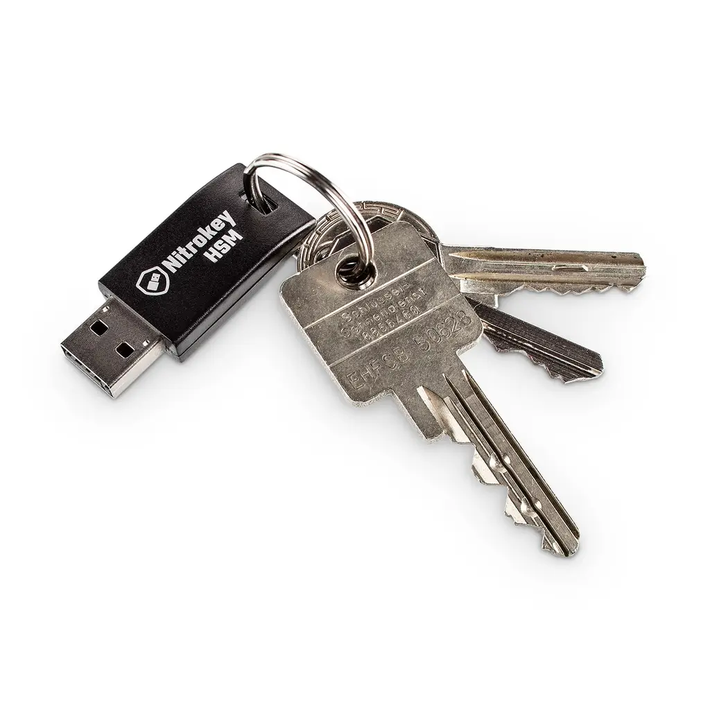

    Secure Key Storage With Professional Key Management

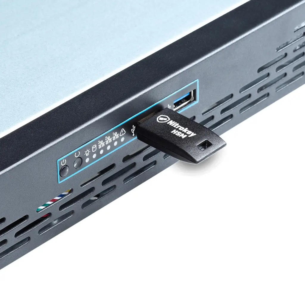

    What was previously only provided by expensive and proprietary hardware security modules (HSM) is now available as open hardware at an unbeatably low price from Germany. Nitrokey HSM reliably protects your cryptographic keys with encrypted backups, two-man rule as access protection and many other security features. With a USB interface, Nitrokey HSM is the ideal solution for certificate infrastructures of any type and size.

    • Life expectancy (MTBF, MTTF): > 500.000 PIN entries
    • Storage time: > 25 years

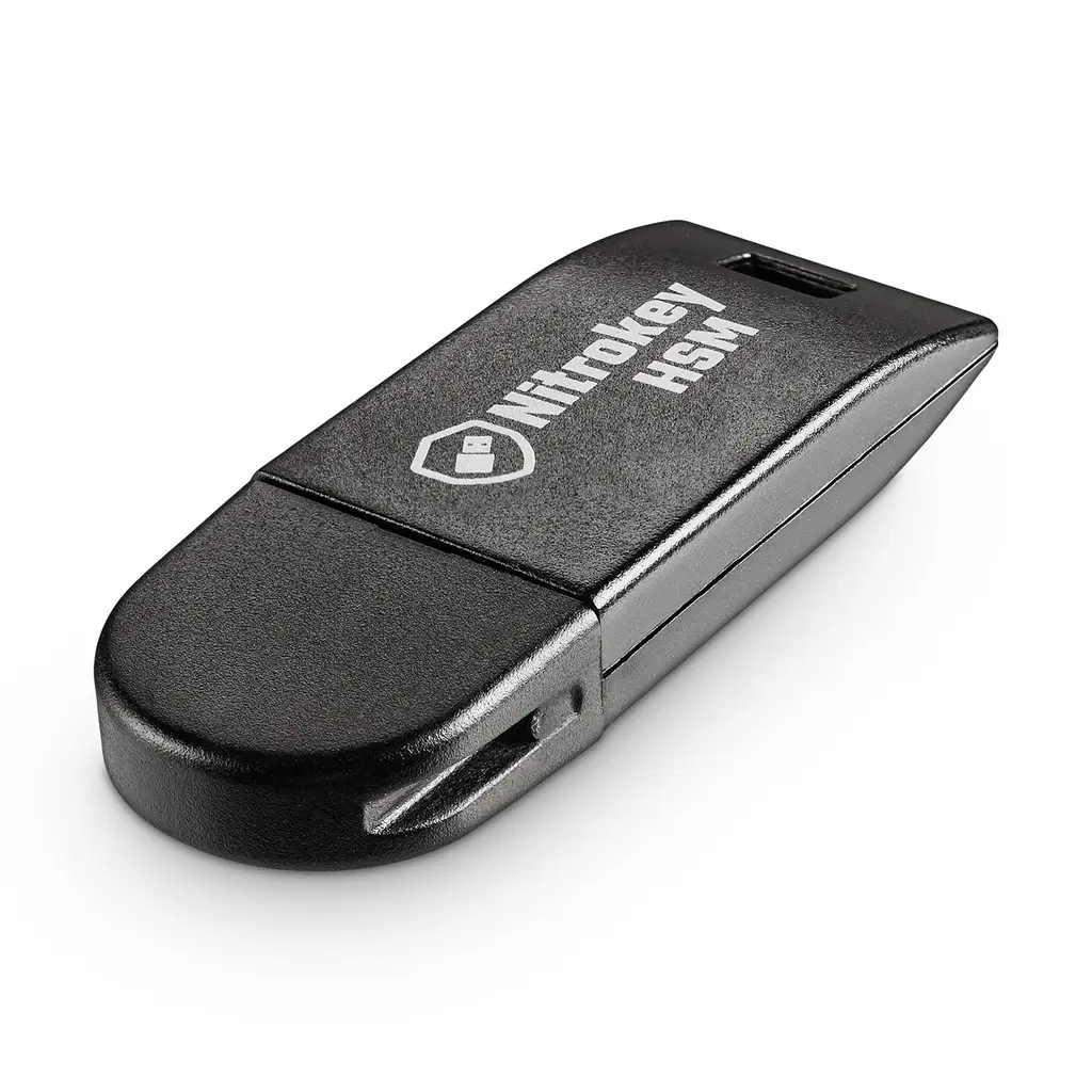

    • Activity indicator: monochrome LED

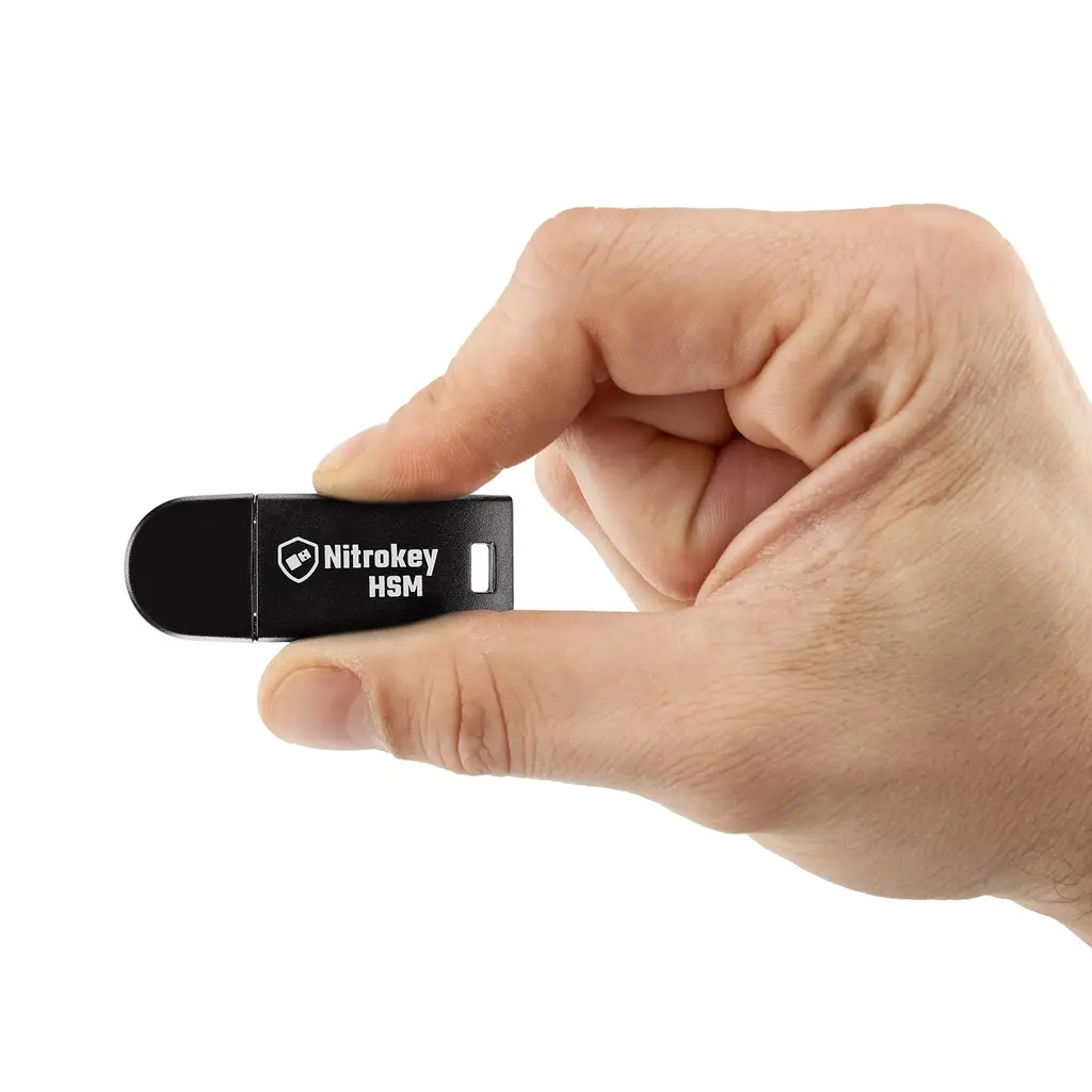

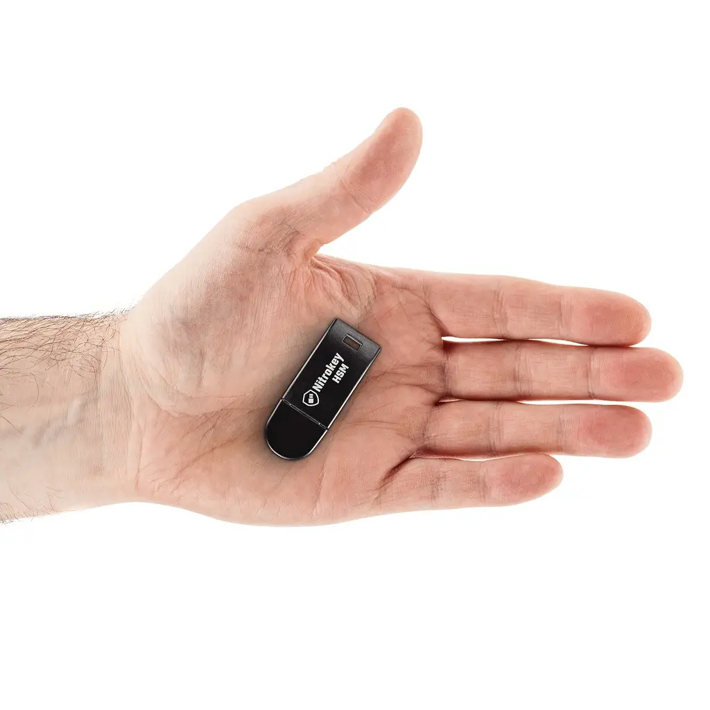

    • Size: 48 x 19 x 7 mm
    • Weight: 6 g
