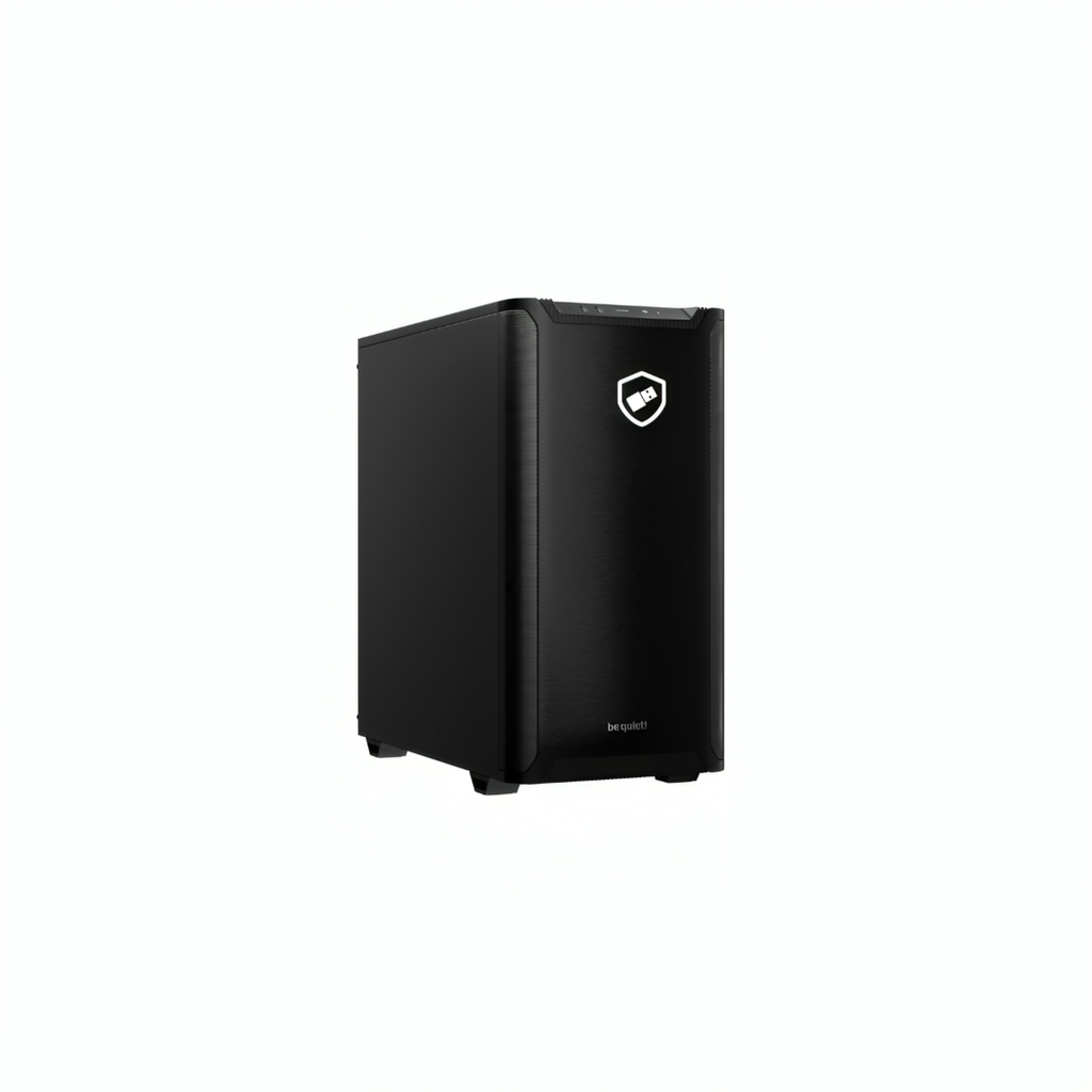

NitroPC Pro 2 - The Secure, Powerful Workstation
The NitroPC Pro 2 is the workstation for high security and performance requirements. The open source firmware Dasharo Coreboot ensures high transparency and security and thus avoids backdoors and security holes in the firmware. The device is certified for the highly secure Qubes OS and comes with either Qubes OS or Ubuntu Linux. Carefully selected components ensure high performance, stability and durability. The Dasharo firmware guarantees continuous firmware development and fast firmware updates.

  • Firmware: Open source Coreboot distribution Dasharo, 1 year subscription inclusive
  • Operating System: Qubes OS, Ubuntu LTS (optional)
  • Processor CPU: 14th Generation Intel Core
  • Graphic GPU: Onboard Intel UHD-Grafik 770. Other graphics cards on request.
  • Speed of the SATA SSD: >500 MB/s
  • Mainboard: MSI PRO Z790-P DDR5 (WIFI optional)
  • Connections front:
    * 2x USB 3.2 Gen 1, 5 Gbps
    * 1x audio jack input
    * 1x audio jack output
  • Connections rear:
    * 4x USB 3.2: 1x (Gen 2x2, 20 Gbps, Type C), 1x (Gen 2, 10 Gbps, Type A), 2x (Gen 1, 5 Gbps, Type A)
    * 4x USB 2.0
    * 2.5 Gbps Ethernet LAN Intel I225-V
    * DisplayPort
    * HDMI
    * PS/2 combination port for keyboard and mouse (UEFI only, doesn't work with HEADS)
    * 2x Wi-Fi antenna (optional)
    * 2x audio jack input
    * 4x audio jack output
  • Power supply: 850 Watt, silent, be quiet! Straight Power 11, 80Plus
  • Casing: black Midi-Tower
  • Dimensions (with feet): 231 x 463 x 450 mm (W x H x D)
  • Weight: ca. 10 kg
